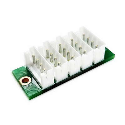

You probably already have all the hardware needed, except for the X3P Hub. This item is hard to purchase nowadays. But the X4P Hub is available now at ROBOTIS USA Shop.
And you can plug X3P cables into an X4P Hub, just make sure to align up properly the X3P connectors for your own use (basically you do not use the 4th pin of the X4P Hub :grinning_face:)
