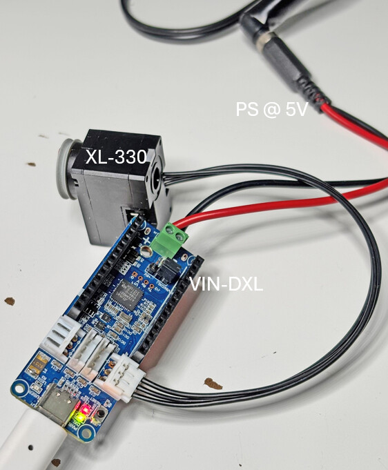

In my particular situation, my hardware setup is shown below:

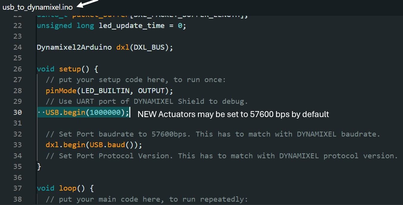

First using Arduino, I downloaded the ROBOTIS example named usb_to_dynamixel.ino to my RB-150 in the regular way,
Make sure you modify for the proper baud to use on Line 30

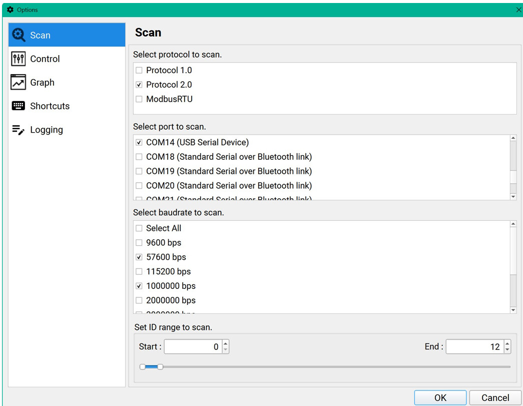

Setup the proper COM Port, and Baud Rate,

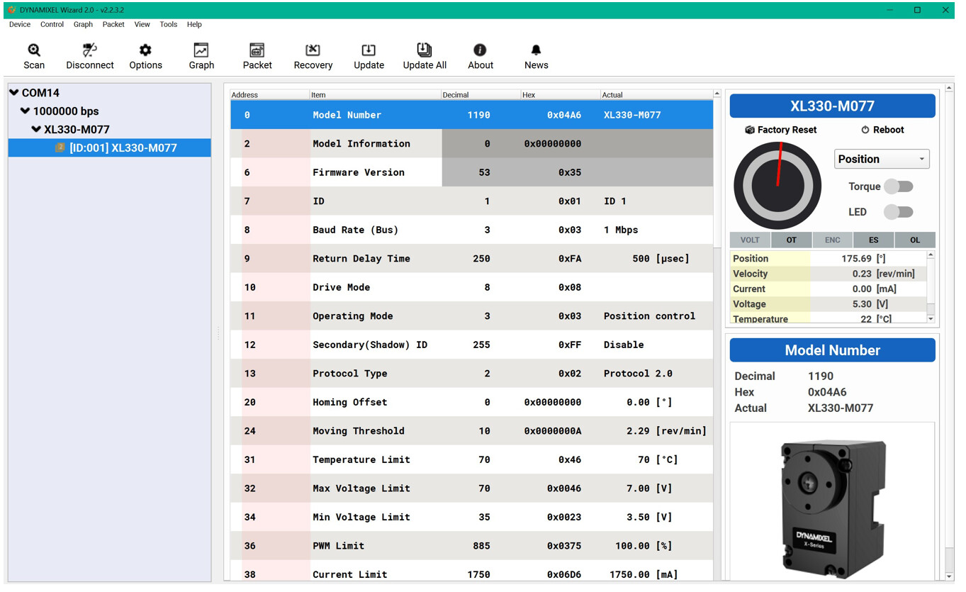

Then you can scan for your DXL
