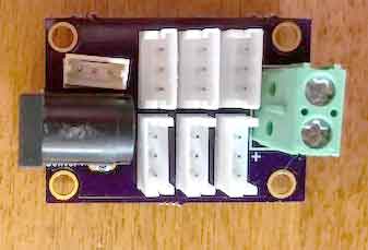

Connecting up to all of the servos, I would run a connection from the U2D2 probably to a HUB. I am not sure if Robotis sells a hub now or not… But one that Trossen now sells:
Has 6 XL like connections as well as an XL320 connection. Originally was setup to be able to XL320 connection from OpenCM9.04 board…
But from a hub like this I would then connect up to each leg. Now depending on real power requirements of these servos, I might use two hubs, and provide separate power to each of the hubs.

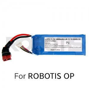

If I actually want it to walk without cables, will then typically use a 3S Lipo. Which one? I don’t know, it often depends on your needs and space and … Example I think the highest capacity one that Robotis sells is:
But then you are carrying that weight. Also maybe you want more than one battery like, maybe 2. So do you have room for 2 of that size or are you better off with the smaller, cheaper, lighter 1000mah versions?
Also remember that the more weight your robot has to carry, the harder the servos have to work. So sometimes larger heavier multiple batteries could be partially self defeating.

Power Hub: 4 times the “U2D2 Power Hub Board Set” would be big and heavy. So my idea is to have one board for power supply (https://www.robotshop.com/eu/en/dimension-engineering-syren-25a-6v-24v-regenerative-motor-driver.html) and one self-made 4-port hub for the 4 legs. When I get it right, the 4 plugs just have to be wired in chain. There I would connect also the stable 12V from my power supply.
Battery: As I need 12V for the servos I would use a 4S Lipo. When I assume 1A avarage for 1 servo when moving and 2A for two Raspis and some electrcity, we have 14A → 14.000mAh for 1 hour. If I like to use the bot for about 20min I would need 4500mAh - 5000mAh. e.g.: https://hobbyking.com/de_de/zippy-compact-4500mah-4s-35c-lipo-pack.html?queryID=52ad023fa1d5c84f17bdde2fe5ab70d8&objectID=24755&indexName=hbk_live_magento_de_de_products - 466g
…I know the problems of weight. My last bot was about 3.8kg and had 6 standard servos, 1.2N stall. Now I have 2.3N (about twice the performance) and about 1kg more (because of accu & servos). The strength of the servos of the last bot have been more than enough, so I think I can get a little bigger this time.

Self made hub:
The one I showed of one from RobotShop is actually one I made myself… I then exported the design files and any one can order them…
IMG_0336-(002)
Again nothing really special. When ordering from OSHPark I ordered the thinner boards with thicker copper
But then again I also use my own servo controller often using one with a Teeny 3.x or 4.x processor. Some of which I have an RPI connector on it and same form factor. I often find I have more fun playing around in the microcontroller code than I do with the Robot code, but for me the main point is to have some fun!
