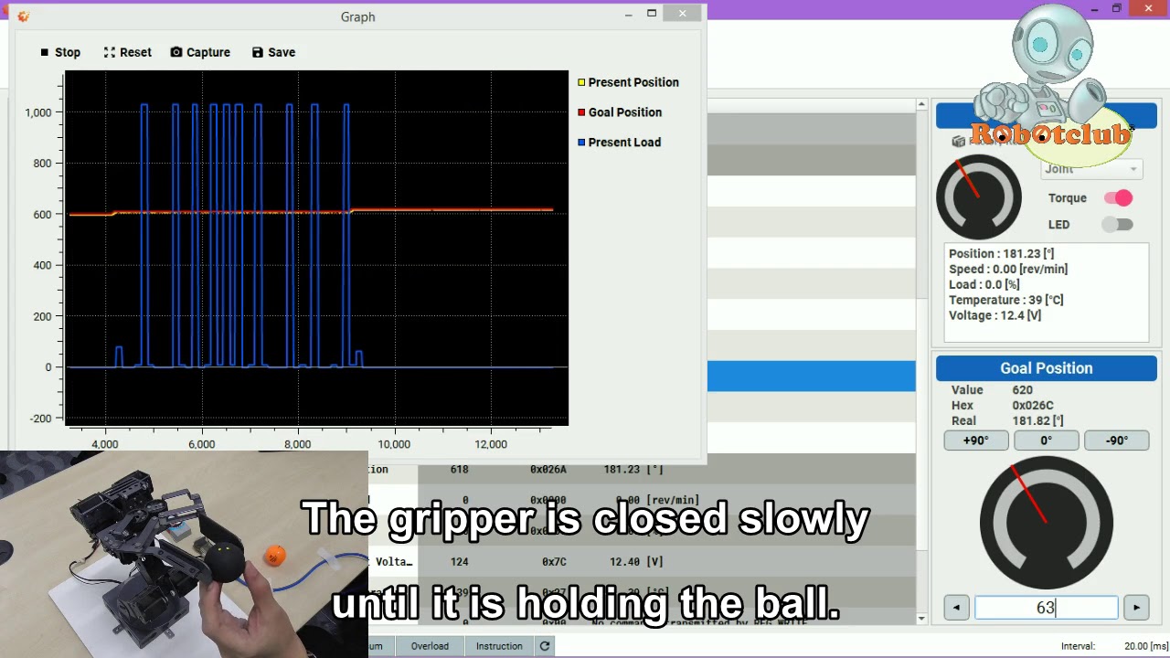

  1. Graph plotting feature : User can select Control Table items to plot data on the graph

Good tutorial video by Robotclub Malaysia
https://community.robotsource.org/t/robotclub-malaysia-dynamixelwizard2-demo-video-shareembedemail/1613
