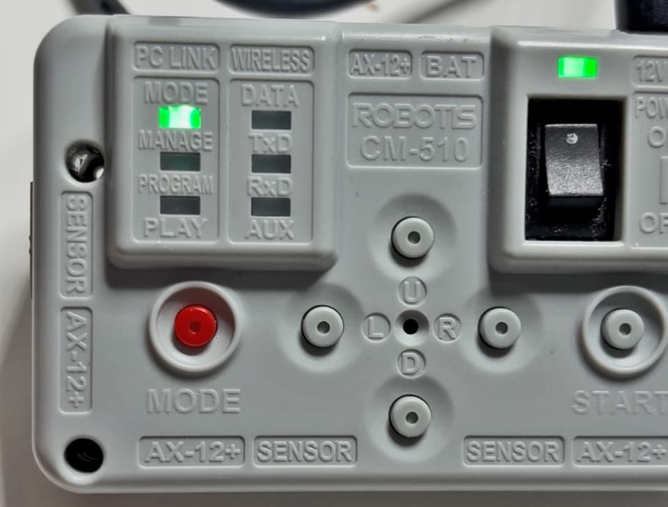

When I turned my CM-510 ON, the MANAGE LED would be blinking as shown below:

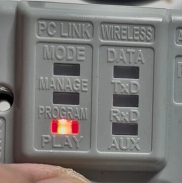

Then if I push ONCE on the RED MODE Button, then the Mode is shifted to PROGRAM so the PROGRAM LED is now blinking.

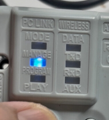

Then if I push ONCE MORE on the RED MODE Button, then it switches to PLAY Mode as shown below:
Is your own CM-510 performing these steps as shown? If it is, your CM-510 is working OK.
