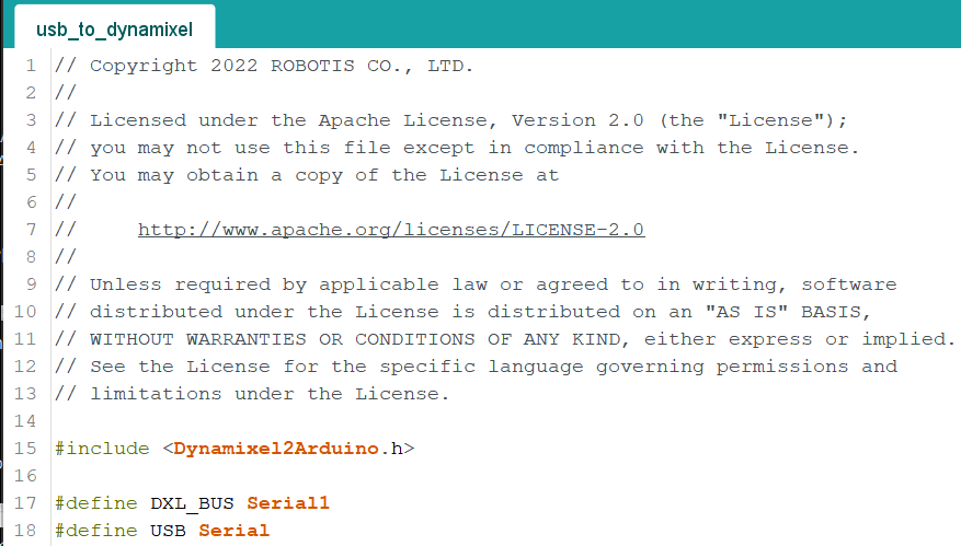

For the users who had problems with the Waveshare Board, @ROBOTISUSA already pointed out a possible “cheaper” alternative to the U2D2 which is the OpenRB-150.
The OpenRB-150 is actually an Arduino board but if the user loads up the example sketch named usb_to_dynamixel.ino
Then the OpenRB-150 acts as a “little brother” to the U2D2 with a maximum baud rate of 1 Mbps (which is fine for XL-330s and XL-430s). While the U2D2 can run at 6 Mbps. But the OpenRB-150 has its own Power Hub and 4 XL type DXL connectors and has a more reasonable price
