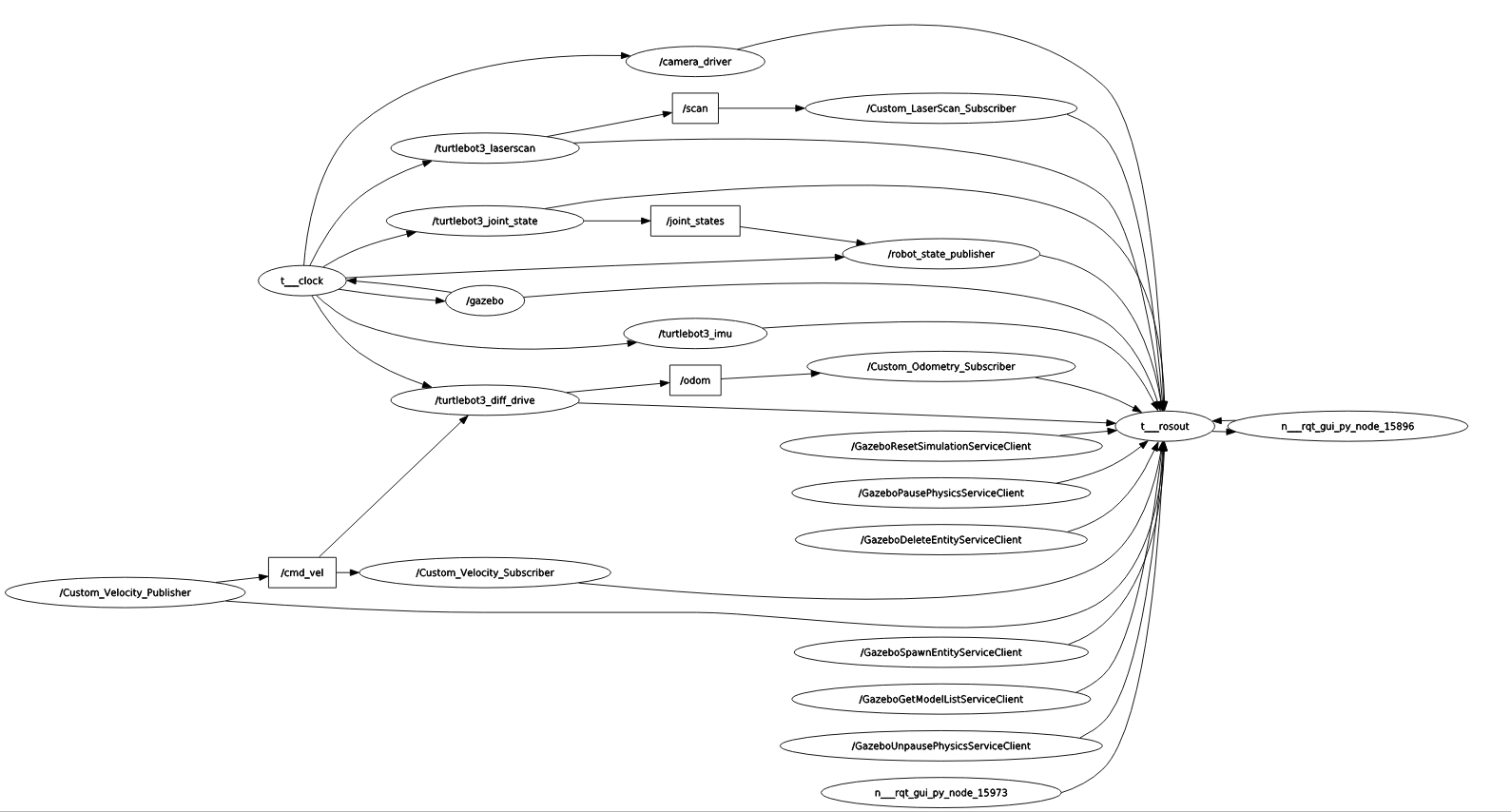

The problem is not that it does not work in general but rather that after a while - after around 3:15 hours - the Gazebo simulation freezes and the LaserScan data is not available anymore. I am now wondering whether this a bug of the Gazebo simulation or of my service call.

I attached a few screenshots to the post, e.g. the Gazebo situation in which the simulation froze, the node graph and the rqt-messages I received.
