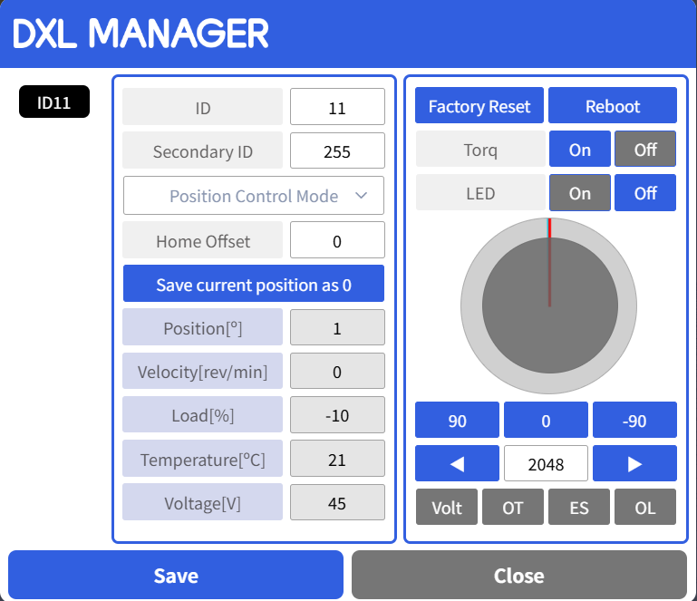

Not sure if this is what you are looking for. But there is a mini DXL manager tool inside the R-Motion tool. Please see this SteamCup post

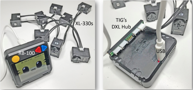

Don’t worry, DXL MANAGER works on RB-88/86 also. Here is my RB-88 with an XL-330 ID=11
