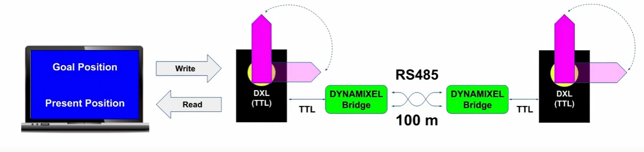

You’ll need to use two TTL/RS-485 Communication Bridge modules - see links

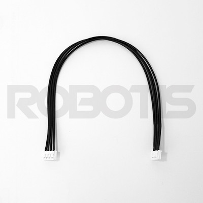

And some X4P cables to connect between the two bridges
There is a YouTube video for all this for up to 100 m distance!
