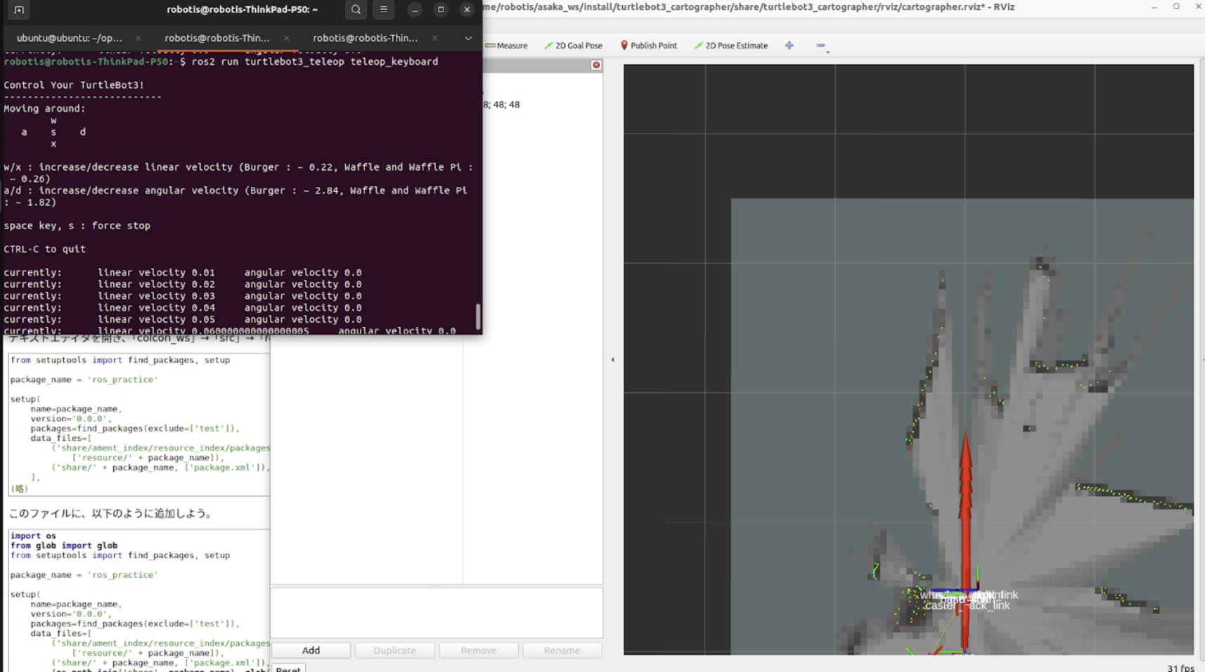

I teleoped at 0.05m/s. Here is an arrow showing the odometry movement at that time.
