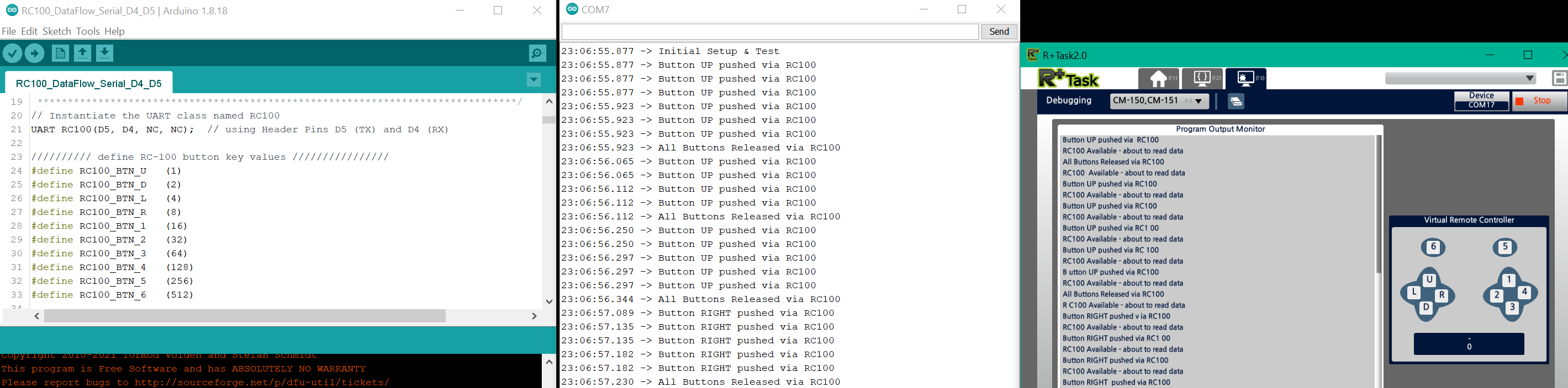

On Pages 1 and 13, I have noticed that D4 is mapped to USART6_RX, and D5 is mapped to USART6_TX, so I connected my BT-210 (RX) to D5 and my BT-210 (TX) to D4.
On the software side, see line 21 of my sketch using the UART class to define my UART Port named RC100. Then I can hook up TASK2 Virtual TASK Output Monitor to get the result shown below:
