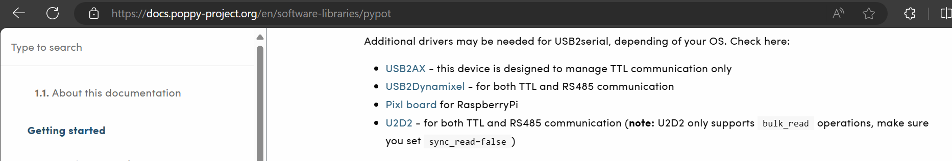

This is what I saw on the Pypot web site
But I am not sure about their statement regarding sync_read as I never had any problem with sync-read when I used ROBOTIS DXL SDK and the U2D2.
