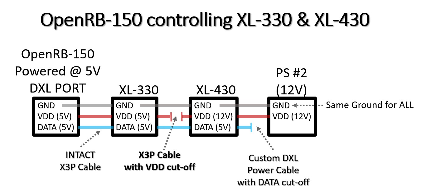

5v and 12v motor control via 1 OpenRB-150?
I have encountered this voltage-mixing in the past and it can be easily solved if you understand the issues/principles involved.
Please visit this following post to get more details, although it was written for an OpenCM-904 controller, the same approach applies for all ROBOTIS controllers.
You will need to create ONE custom X3P DXL Power Cable, see this post:
and ONE custom X3P cable (with VDD cut off) to serve as an “electrical isolation” between the 5V DXLs and 12V DXLs (i.e. for the 2 Power Circuits), and as an “electrical bridge” for the Control Circuit which should be common to ALL DXLs and connected back to the OpenRB-150.
Please check these posts first. And then if you have more questions, just ask away back at this current post.
