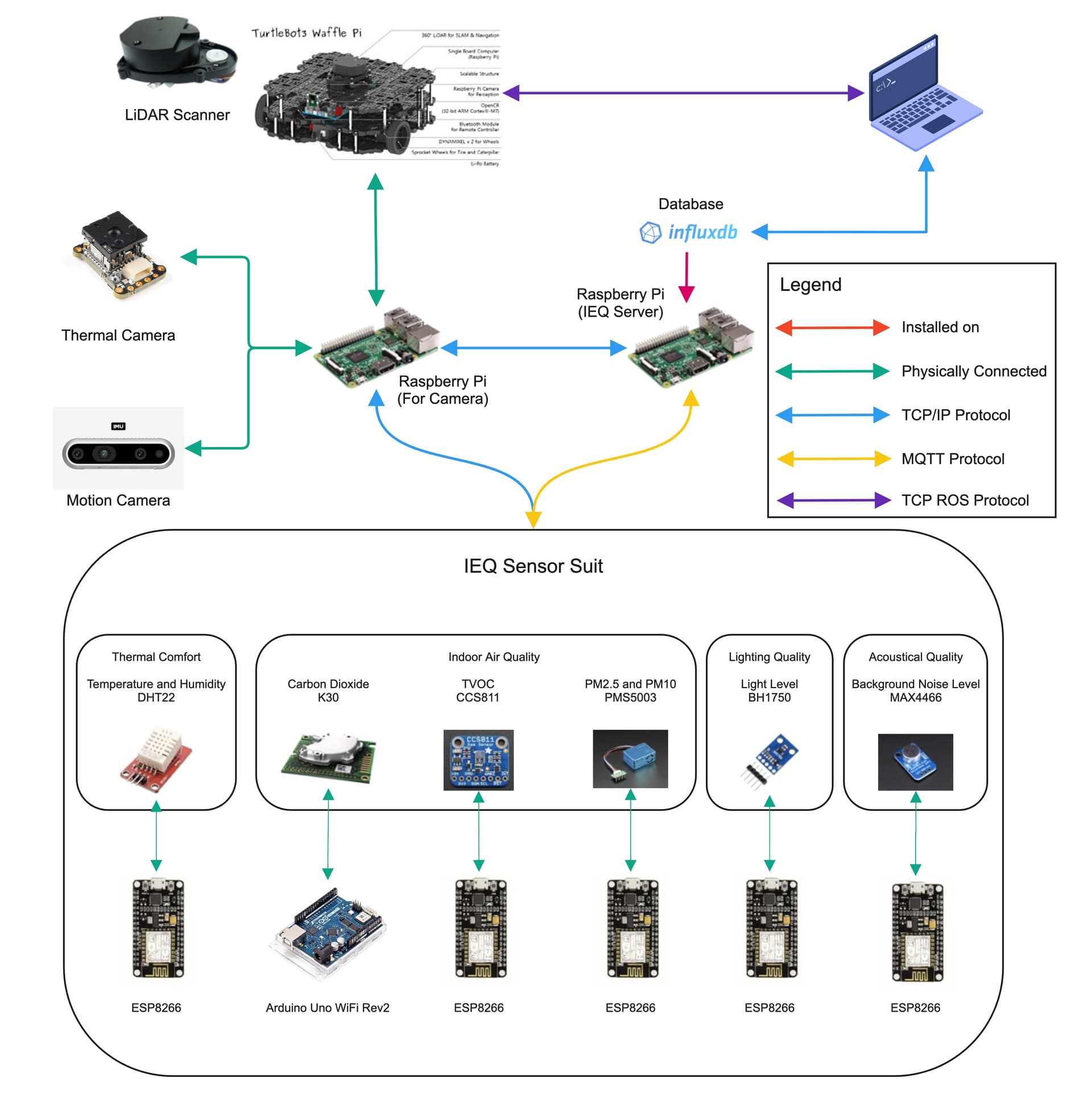

Our team in School of Architecture at Carnegie Mellon University has developed an automatic mobile sensing platform using Turtlebot3 that will help provide IEQ assessments simultaneously, continuously, and remotely.
The platform includes an infrared thermal camera, an RGB-D camera, temperature and relative humidity sensors, acoustic sensors, particulate matter sensors, and CO2 sensors. Based on the measurements of both IEQ and building envelope, the inspectors can identify the IEQ-related problems caused by the deterioration of the building envelope, dis-functioning HVAC equipment, and occupants-eccentric issues.
The diagram of the mobile sensing platform is as follows:
