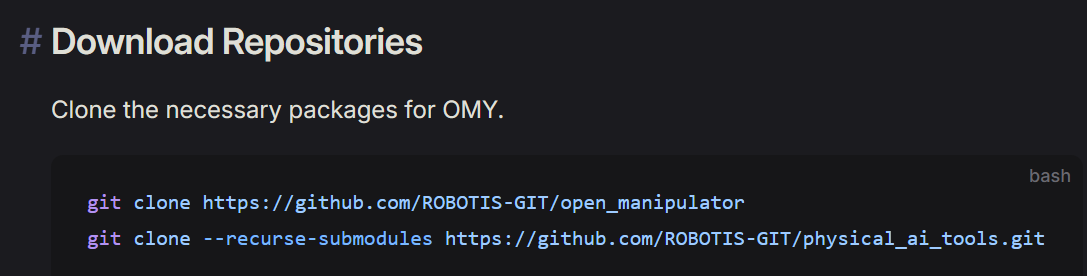

  4. From the software installation instructions available via the web page
    Setup Guide for OMY | ROBOTIS
The user should only install the two packages “open_manipulator” and “physical_ai_tools” on the RPi5. And install same tools on the Linux PC side?

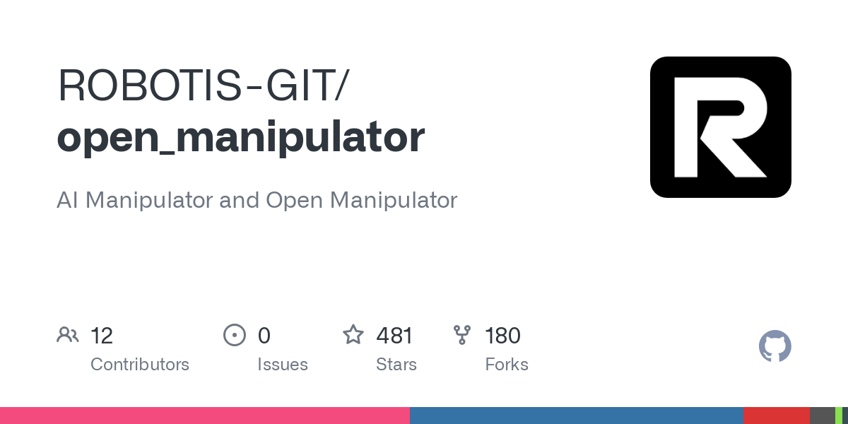

The OMY SBC comes with a custom real-time patched OS. All software runs inside Docker containers. The software stack on the SBC and the User PC is identical in terms of container images.
  • The open_manipulator container is pre-installed on the OMY SBC, and the open_manipulator_bringup process should be launched from the SBC.
  • For better performance, it’s recommended to run the rest of the applications from the User PC.
Regarding OMX, it is shipped without an SBC.

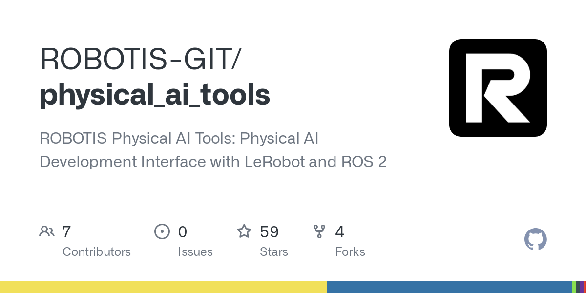

As for physical-ai-tools, this package is specifically for imitation learning and requires an NVIDIA GPU to run deep learning models. Therefore, it should be installed and used on the User PC, not on the OMY SBC.
Since the OMY uses a custom OS, installing ROS natively on the SBC is not straightforward. It’s better to use the preconfigured Docker containers. However, if you’re using a general-purpose OS on your own SBC, you can install ROS natively and build packages from source.
