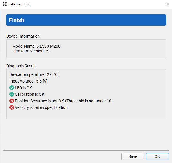

XL330-M288-T _ Self Diagnose Result

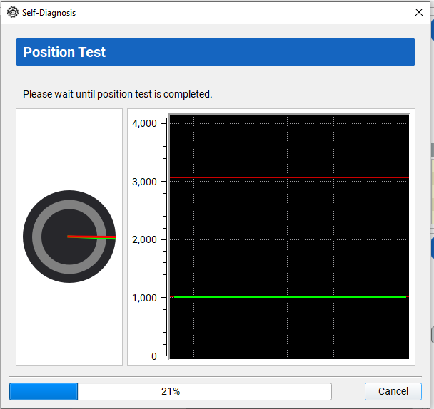

XL330-M288-T _ Position Test (Self Diagnose) - I noticed the DYNAMIXEL servo only turned once, then no action after that, but the Self Diagnostic process still continued until the end, and it achieved max velocity during the test (the test after Position Test).

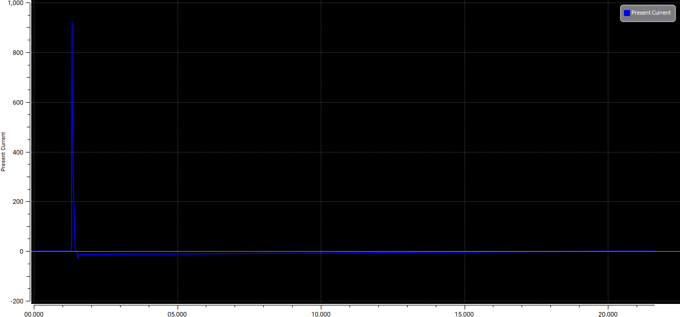

XL330-M288-T _ Present Current

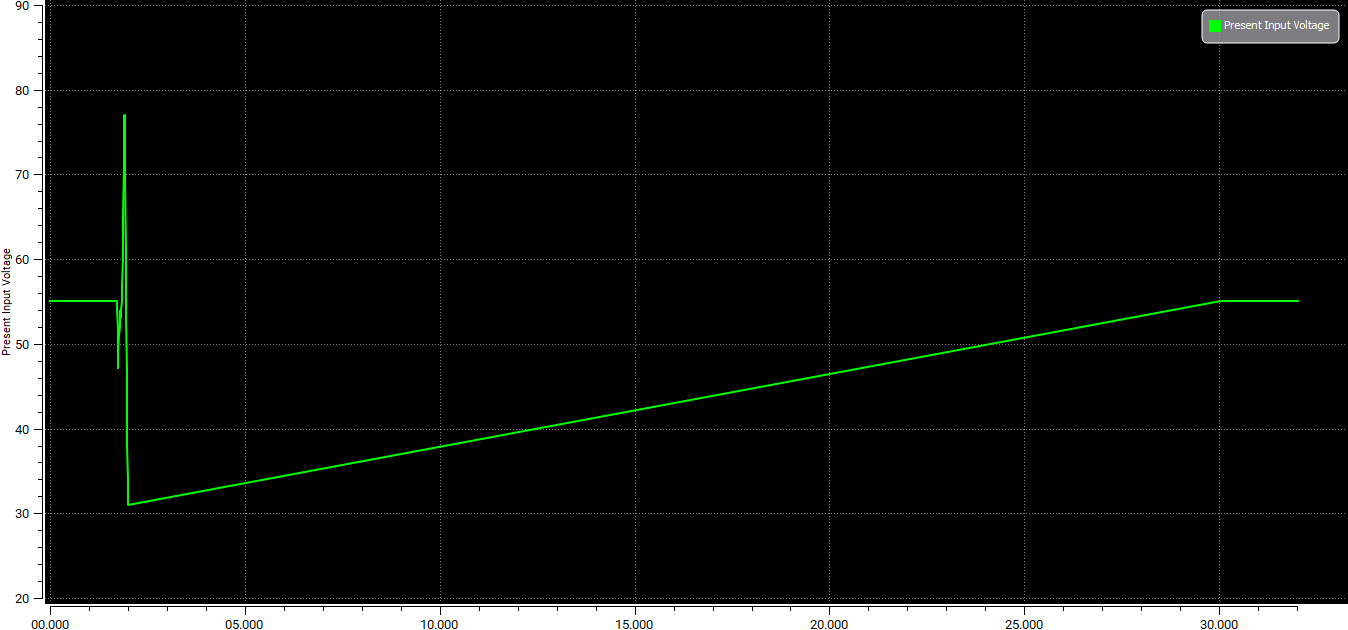

XL330-M288-T _ Present Input Voltage

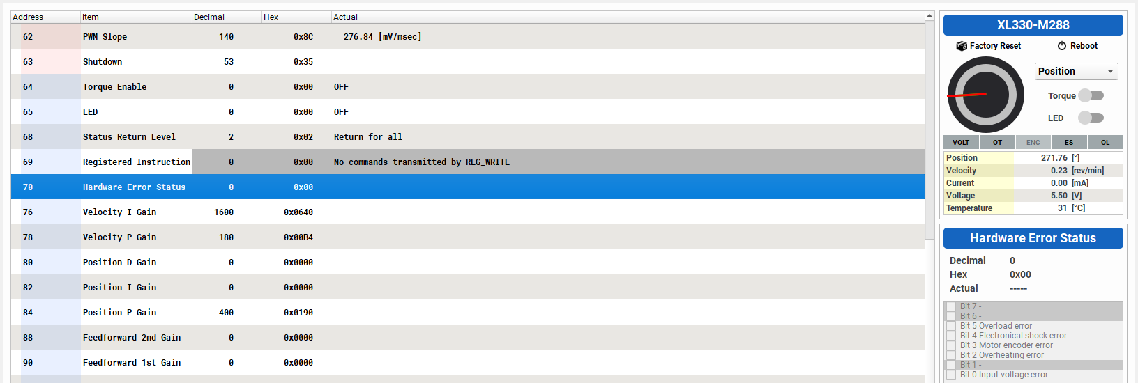

XL330-M288-T _ Hardware Error Status (70) - There is no hardware error, so hopefully mine is not a faulty DYNAMIXEL servo. Fingers crossed.

Probable Root Cause: Insufficient Power Supply
When the servo moves, increased current draw causes voltage to drop below operating threshold, triggering an automatic reboot and timeout error.
Quick Diagnostic
Check for power-related reboot:
  • Observe if the red LED blinks when you enable torque and change goal position
  • Blinking red LED indicates the servo may be rebooting due to power issues
Test your power supply:
  1. Switch to Current Control Mode
  2. Gradually increase Goal Current value
  3. If voltage drops and the servo reboots, your power supply is insufficient
Credit: Woojin Wie
Great sharing! Curious about the current rating on your power supply. How much was the rated amperage?
