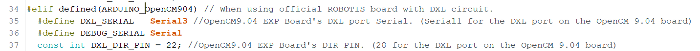

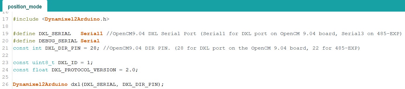

Are you using the “Dynamixel2Arduino” library? i.e. regular Arduino IDE and not the old deprecated OpenCM IDE:
Then you need to set up the right Serial Port and Directional Pin:
Assuming your XL-430 is attached to the 485-EXP board, then you need to use
#define DXL_SERIAL Serial3
const int DXL_DIR_PIN = 22
then
Dynamixel2Arduino dxl(DXL_SERIAL, DXL_DIR_PIN);

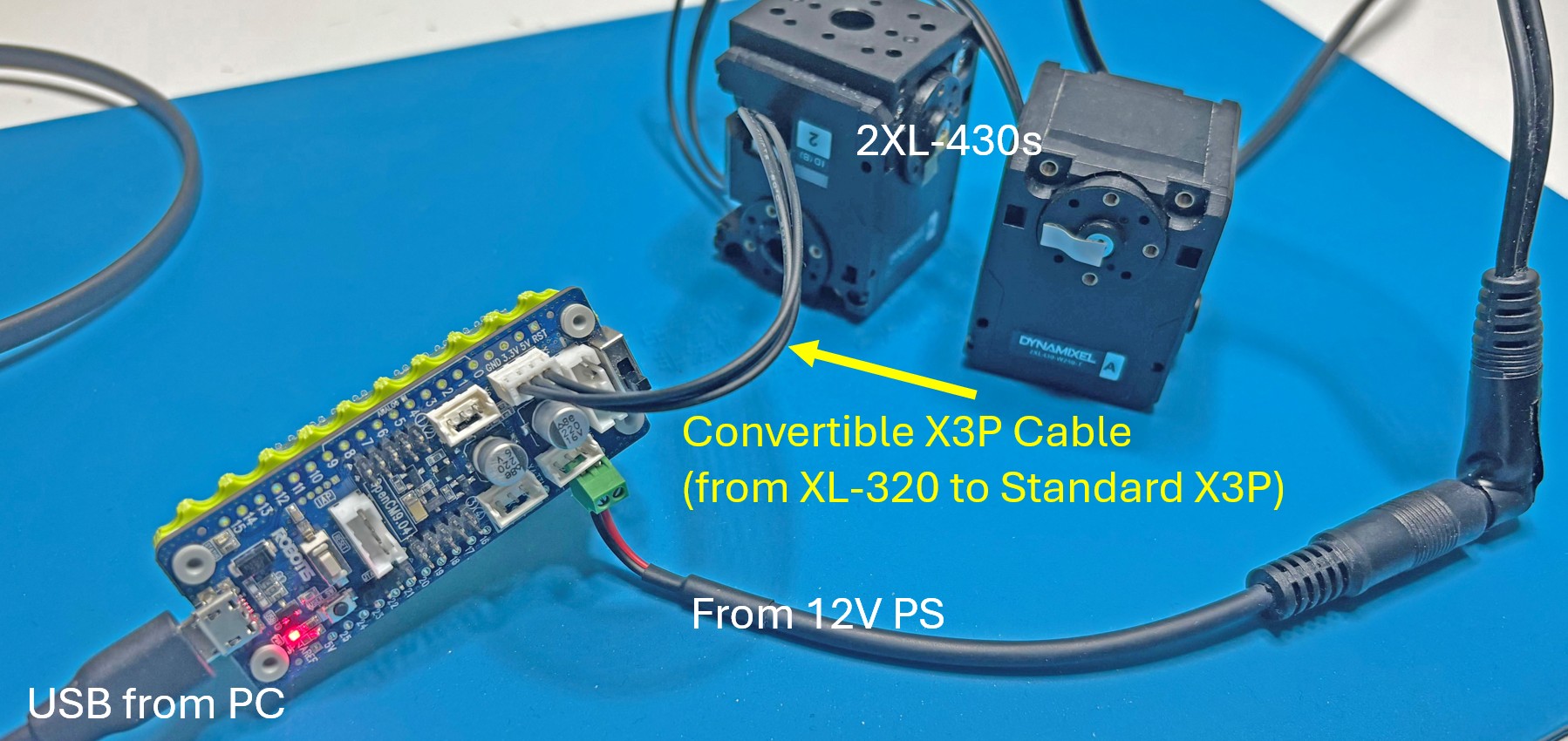

BTW, when you are ready to move away from OpenCM IDE to the current Arduino IDE, and if you are only using X3P-TTL servos such as the XL-430s, there is another hardware/software option for users of the OpenCM-904C, that does not require the 485-EXP. See the setup below:
As you can see, there are several hardware modifications to be done:
  1. You need to solder in a small Terminal Block to the (+, -) pins on the OpenCM-904C, then you can feed 11.1-12 V DC there to the board.
  2. You need a special convertible cable that goes from the XL-320 connector on the OpenCM-904 to the standard X3P connector on the XL-430. This cable will power and control the XL-430s from Arduino.
For some strange reason, I cannot find this type of cable on the Korean Web Shop! But the USA shop carries this cable (which is “out of stock” currently).
  1. You can still use the USB port as normal to download your Arduino sketch to the 904.

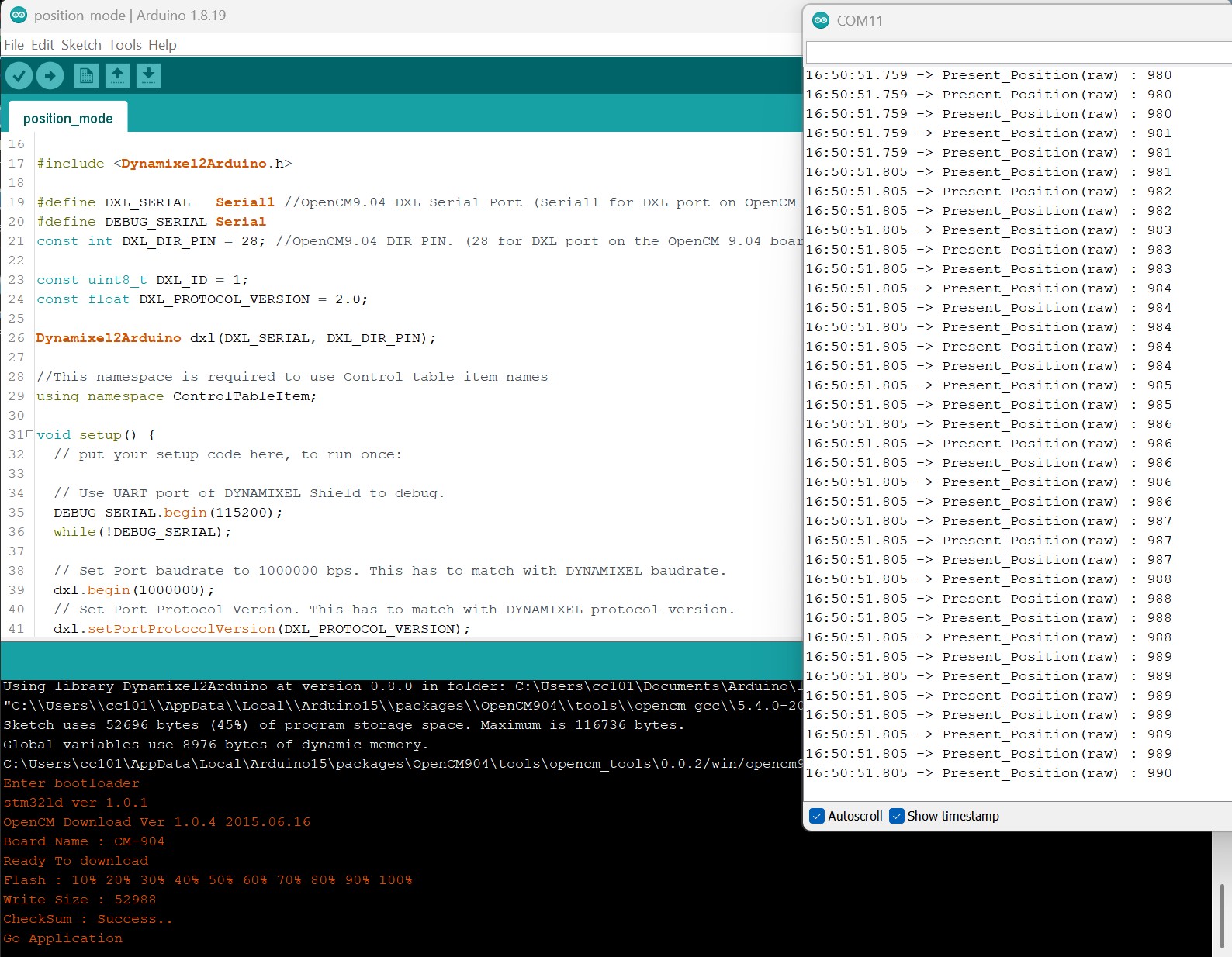

  2. Software-wise, you’ll need to switch to the Arduino IDE and the Dynamixel2Arduino library, and you can use the example sketches that come with it. As an example, I cleaned up a little bit the provided example sketch named “position_mode.ino” to show the correct Serial Port and Directional Pin to be used in this case (i.e. Serial1 and 28):
An sample runtime shot is shown below:

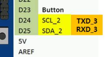

When you use the OpenCM-904 without the 485-EXP then you free up Serial3 (Pins D24 and D25) which now can be used as an extra I2C or UART port
