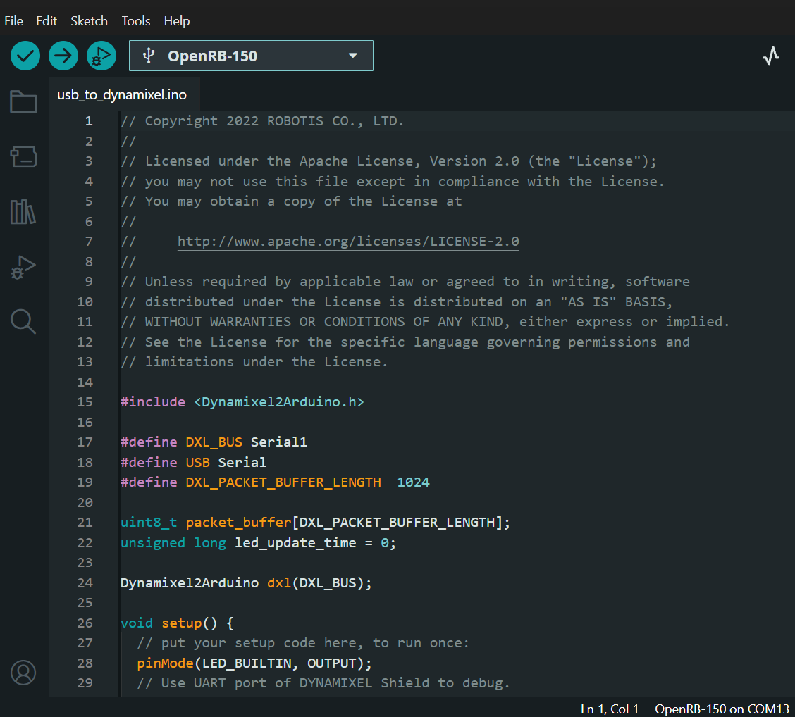

Also there is another hardware design solution that you missed. As you already have an OpenRB-150, there is a way to make the 150 behaves like a mini U2D2 (up to 1 Mbps baud rate only) + as a DXL Power Hub, then you can control your DXLs directly from the PC also, please see this post:

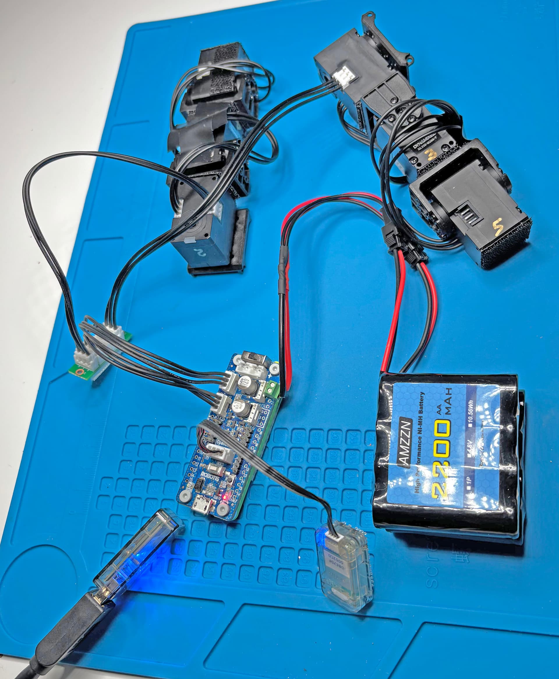

I also found that this Power Setup using 2 NiMH Batteries in parallel (4.8 V each and 2200 mAh each) can power an OpenCM-904 and 6 XL-330s OK. However, 1 battery pack was not enough, so look for at least 4400 mAh for your battery solution.

Thank you, I was able to get the 6 XL330 motors running with the OpenRB usb2dynamixel code, I plan to get the Lithium-Ion 4400mAh battery. Do I need to use a dc step converter to step up to 5v or can it work with the 3.7v?
