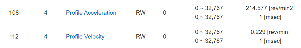

Assuming that you are using Position Control mode, then by default, the XW-430 use Profile Acceleration and Profile Velocity parameters set to ZERO. Are these parameters set at 0 for your XW-430?
And surprisingly these settings will make the actuator go “as fast as possible”. You can view this YouTube video to see how Profile Acceleration and Profile Velocity can be set to help control your XW-430 to work at the speed and smoothness that you need for your project.

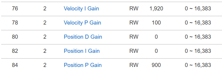

In the past, some users needed to use very slow speeds, then they even needed to manipulate the P parameter of the PID Control System
