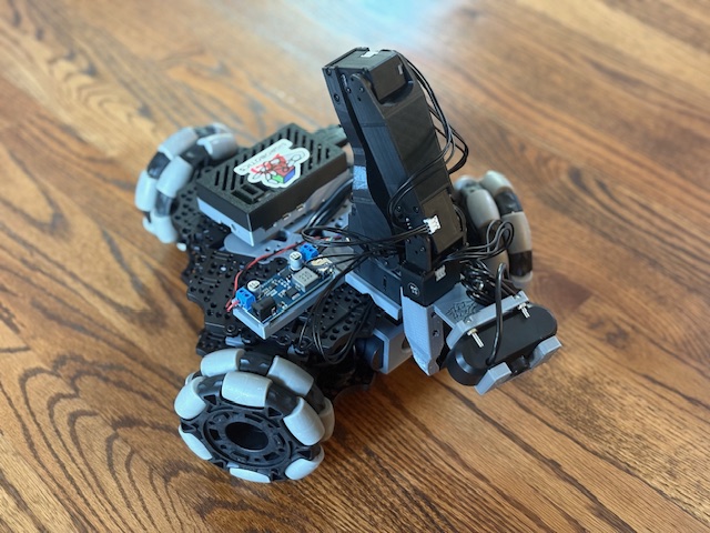

:rocket: Introducing our Dynamixel-powered redesign of LeKiwi โ€” an open-source, low-cost holonomic drive mobile manipulator developed by SIGRobotics at UIUC :robot:
Weโ€™ve upgraded LeKiwi to use:
:wrench: The Koch v1.1 robotic arm
:video_game: The U2D2 motor controller
:gear: Dynamixel XL-430 smart servos for a robust and smooth-driving mobile base
:hammer_and_wrench: TurtleBot3 (TB3) base plates for a standardized, modular platform
:brain: LeKiwi runs onboard compute using a Raspberry Pi 5,
:camera: with dual cameras for both workspace and wrist views โ€” ideal for teleoperation, data collection, and vision-based learning

I have reviewed the BOM listed on your GitHub pages, and I am still confused by how you powered the whole robot. Your video shows that you can use the robot with battery power only. The BOM shows only 1 battery rated for 12V and 5A and 2 wall-plugged PS - one for 5V and one for 12V. Can that single 12V 5A battery power the whole robot as seen in the videos?
Yes, that single 12v 5a (rechargeable) Li-ion battery powers the entire robot as shown in the video.
Good Find! For RPi5, I thought that I had to go with fancier UPS HAT solutions, using 21700 batteries, that overall would cost practically double. But they do have more bells and whistles!
