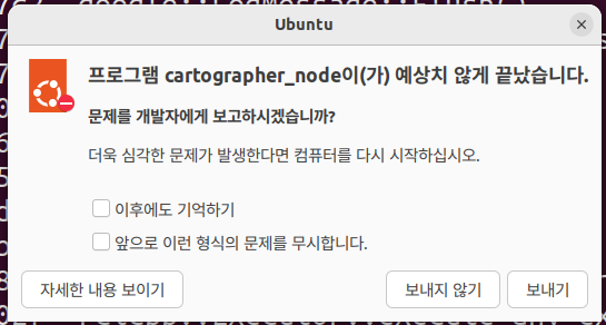

추가로, ros2 launch turtlebot3_cartographer cartographer.launch.py 실행하면
우분투 경고 창과 함께
프로그램 cartographer_node이(가) 예상치 않게 끝났습니다. 가 나옵니다

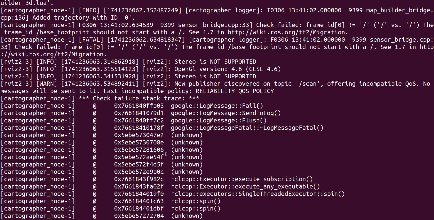

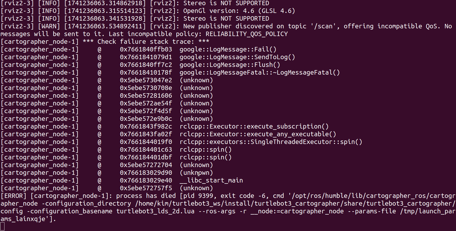

네 remote PC에서 입력했을 때 나오는 문제입니다.
[INFO] [launch]: All log files can be found below /home/kim/.ros/log/2025-03-04-18-01-45-884286-kim-VivoBook-ASUSLaptop-X403JA-X403JA-11274
[INFO] [launch]: Default logging verbosity is set to INFO
[INFO] [cartographer_node-1]: process started with pid [11275]
[INFO] [cartographer_occupancy_grid_node-2]: process started with pid [11277]
[INFO] [rviz2-3]: process started with pid [11279]
[rviz2-3] Warning: Ignoring XDG_SESSION_TYPE=wayland on Gnome. Use QT_QPA_PLATFORM=wayland to run on Wayland anyway.
[cartographer_node-1] [INFO] [1741078905.985851686] [cartographer logger]: I0304 18:01:45.000000 11275 configuration_file_resolver.cc:41] Found ‘/home/kim/turtlebot3_ws/install/turtlebot3_cartographer/share/turtlebot3_cartographer/config/turtlebot3_lds_2d.lua’ for ‘turtlebot3_lds_2d.lua’.
[cartographer_node-1] [INFO] [1741078905.986144196] [cartographer logger]: I0304 18:01:45.000000 11275 configuration_file_resolver.cc:41] Found ‘/opt/ros/humble/share/cartographer/configuration_files/map_builder.lua’ for ‘map_builder.lua’.
[cartographer_node-1] [INFO] [1741078905.986166673] [cartographer logger]: I0304 18:01:45.000000 11275 configuration_file_resolver.cc:41] Found ‘/opt/ros/humble/share/cartographer/configuration_files/map_builder.lua’ for ‘map_builder.lua’.
[cartographer_node-1] [INFO] [1741078905.986210212] [cartographer logger]: I0304 18:01:45.000000 11275 configuration_file_resolver.cc:41] Found ‘/opt/ros/humble/share/cartographer/configuration_files/pose_graph.lua’ for ‘pose_graph.lua’.
[cartographer_node-1] [INFO] [1741078905.986241419] [cartographer logger]: I0304 18:01:45.000000 11275 configuration_file_resolver.cc:41] Found ‘/opt/ros/humble/share/cartographer/configuration_files/pose_graph.lua’ for ‘pose_graph.lua’.
[cartographer_node-1] [INFO] [1741078905.986356075] [cartographer logger]: I0304 18:01:45.000000 11275 configuration_file_resolver.cc:41] Found ‘/opt/ros/humble/share/cartographer/configuration_files/trajectory_builder.lua’ for ‘trajectory_builder.lua’.
[cartographer_node-1] [INFO] [1741078905.986371456] [cartographer logger]: I0304 18:01:45.000000 11275 configuration_file_resolver.cc:41] Found ‘/opt/ros/humble/share/cartographer/configuration_files/trajectory_builder.lua’ for ‘trajectory_builder.lua’.
[cartographer_node-1] [INFO] [1741078905.986399571] [cartographer logger]: I0304 18:01:45.000000 11275 configuration_file_resolver.cc:41] Found ‘/opt/ros/humble/share/cartographer/configuration_files/trajectory_builder_2d.lua’ for ‘trajectory_builder_2d.lua’.
[cartographer_node-1] [INFO] [1741078905.986411929] [cartographer logger]: I0304 18:01:45.000000 11275 configuration_file_resolver.cc:41] Found ‘/opt/ros/humble/share/cartographer/configuration_files/trajectory_builder_2d.lua’ for ‘trajectory_builder_2d.lua’.
[cartographer_node-1] [INFO] [1741078905.986504320] [cartographer logger]: I0304 18:01:45.000000 11275 configuration_file_resolver.cc:41] Found ‘/opt/ros/humble/share/cartographer/configuration_files/trajectory_builder_3d.lua’ for ‘trajectory_builder_3d.lua’.
[cartographer_node-1] [INFO] [1741078905.986517918] [cartographer logger]: I0304 18:01:45.000000 11275 configuration_file_resolver.cc:41] Found ‘/opt/ros/humble/share/cartographer/configuration_files/trajectory_builder_3d.lua’ for ‘trajectory_builder_3d.lua’.
[cartographer_node-1] [INFO] [1741078905.998973353] [cartographer logger]: I0304 18:01:45.000000 11275 map_builder_bridge.cpp:136] Added trajectory with ID ‘0’.
[cartographer_node-1] F0304 18:01:46.033547 11275 sensor_bridge.cpp:33] Check failed: frame_id[0] != ‘/’ (‘/’ vs. ‘/’) The frame_id /base_footprint should not start with a /. See 1.7 in tf2/Migration - ROS Wiki.
[cartographer_node-1] [FATAL] [1741078906.033895458] [cartographer logger]: F0304 18:01:46.000000 11275 sensor_bridge.cpp:33] Check failed: frame_id[0] != ‘/’ (‘/’ vs. ‘/’) The frame_id /base_footprint should not start with a /. See 1.7 in tf2/Migration - ROS Wiki.
[rviz2-3] [INFO] [1741078906.572663893] [rviz2]: Stereo is NOT SUPPORTED
[rviz2-3] [INFO] [1741078906.572795080] [rviz2]: OpenGl version: 4.6 (GLSL 4.6)
[rviz2-3] [INFO] [1741078906.590103604] [rviz2]: Stereo is NOT SUPPORTED
[rviz2-3] [WARN] [1741078906.731736338] [rviz2]: New publisher discovered on topic ‘/scan’, offering incompatible QoS. No messages will be sent to it. Last incompatible policy: RELIABILITY_QOS_POLICY
[cartographer_node-1] *** Check failure stack trace: ***
[cartographer_node-1] @ 0x7776c1ffab03 google::LogMessage::Fail()
[cartographer_node-1] @ 0x7776c20029d1 google::LogMessage::SendToLog()
[cartographer_node-1] @ 0x7776c1ffa7c2 google::LogMessage::Flush()
[cartographer_node-1] @ 0x7776c1ffc78f google::LogMessageFatal::~LogMessageFatal()
[cartographer_node-1] @ 0x62895b61a7e2 (unknown)
[cartographer_node-1] @ 0x62895b61d08e (unknown)
[cartographer_node-1] @ 0x62895b597606 (unknown)
[cartographer_node-1] @ 0x62895b5c454f (unknown)
[cartographer_node-1] @ 0x62895b60ad5f (unknown)
[cartographer_node-1] @ 0x62895b5ffb0c (unknown)
[cartographer_node-1] @ 0x7776c22f482c rclcpp::Executor::execute_subscription()
[cartographer_node-1] @ 0x7776c22f502f rclcpp::Executor::execute_any_executable()
[cartographer_node-1] @ 0x7776c22fc9f0 rclcpp::executors::SingleThreadedExecutor::spin()
[cartographer_node-1] @ 0x7776c22fcc63 rclcpp::spin()
[cartographer_node-1] @ 0x7776c22fcdbf rclcpp::spin()
[cartographer_node-1] @ 0x62895b588704 (unknown)
[cartographer_node-1] @ 0x7776c0e29d90 (unknown)
[cartographer_node-1] @ 0x7776c0e29e40 __libc_start_main
[cartographer_node-1] @ 0x62895b58b7f5 (unknown)
[ERROR] [cartographer_node-1]: process has died [pid 11275, exit code -6, cmd ‘/opt/ros/humble/lib/cartographer_ros/cartographer_node -configuration_directory /home/kim/turtlebot3_ws/install/turtlebot3_cartographer/share/turtlebot3_cartographer/config -configuration_basename turtlebot3_lds_2d.lua --ros-args -r __node:=cartographer_node --params-file /tmp/launch_params_1txr4n7k’].

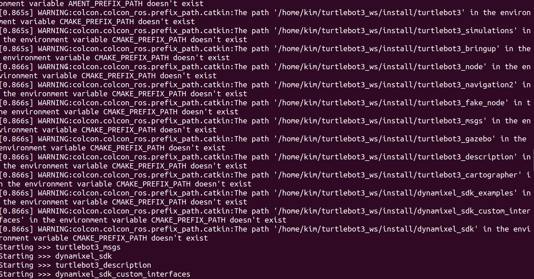

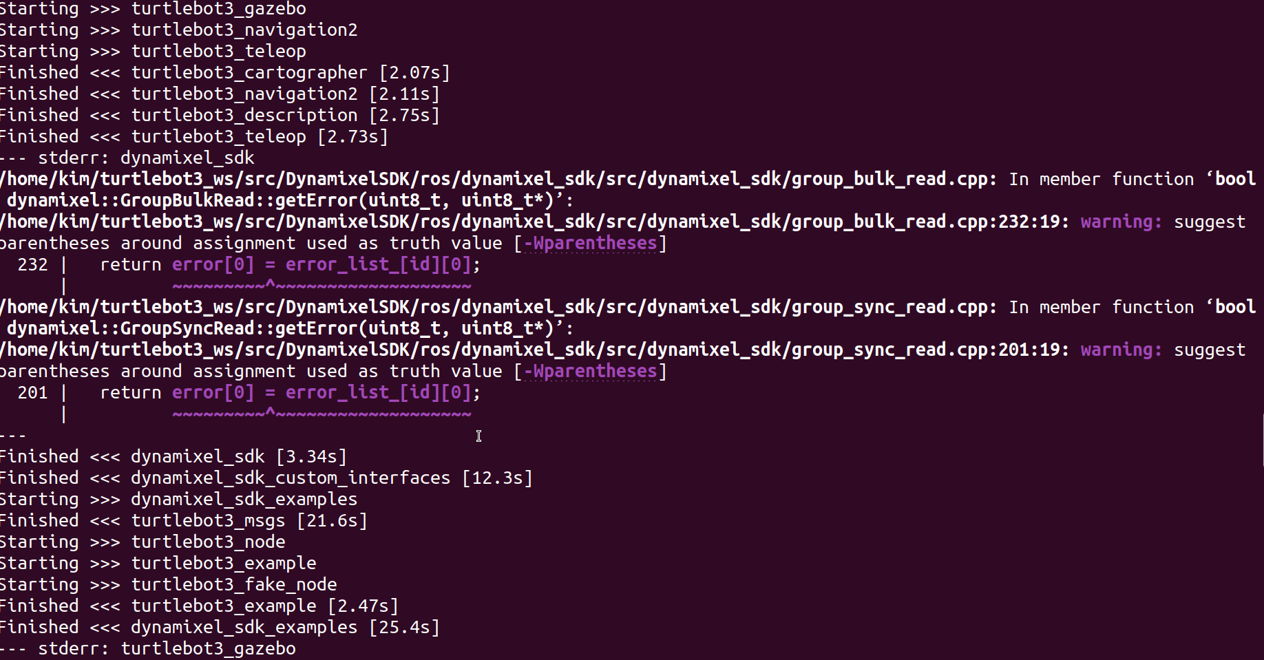

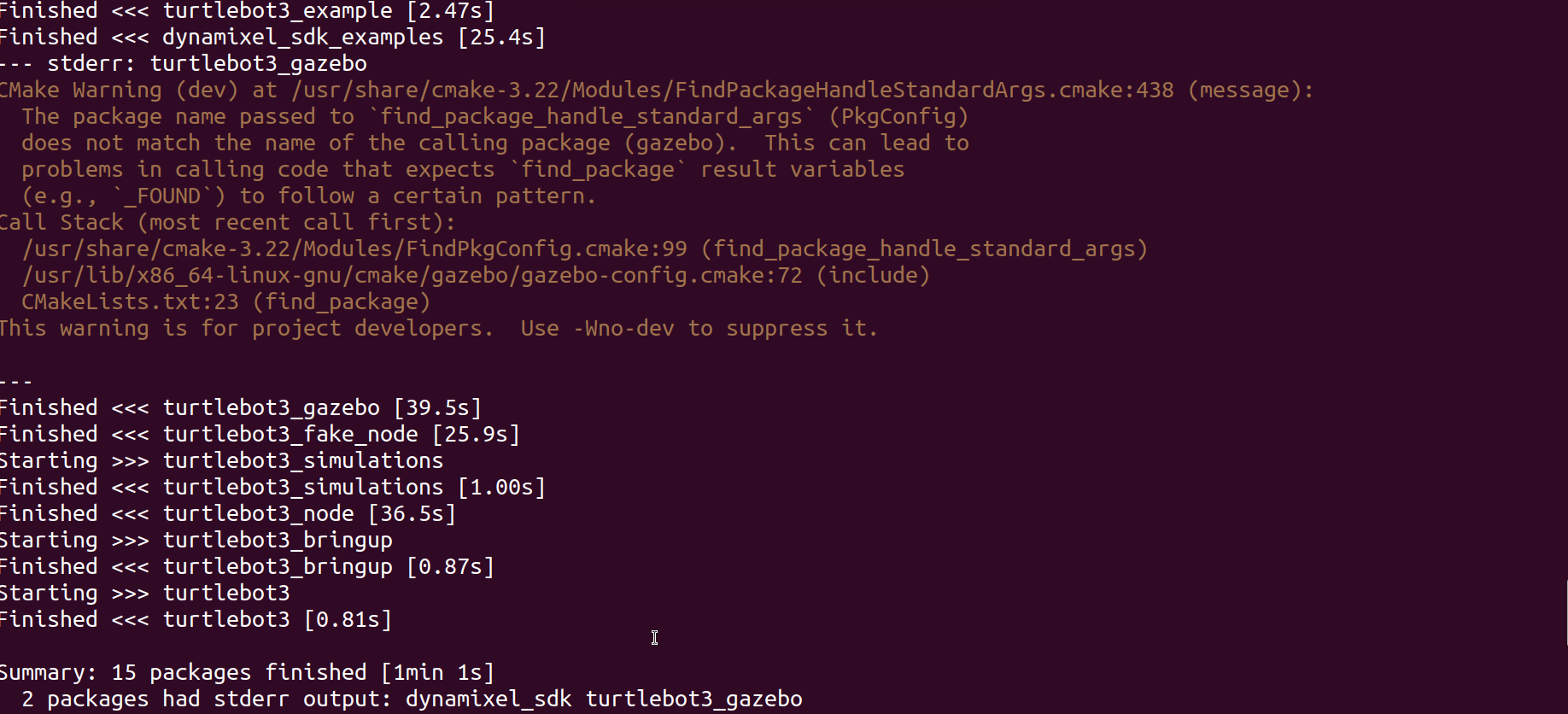

:white_check_mark: 3. 워크스페이스 정리 및 빌드
이후 아래 명령어를 실행하여 워크스페이스를 정리하고 다시 빌드한 뒤 실행해 보시기 바랍니다.
cd ~/turtlebot3_ws
rm -rf build install log
colcon build --symlink-install
source install/local_setup.bash

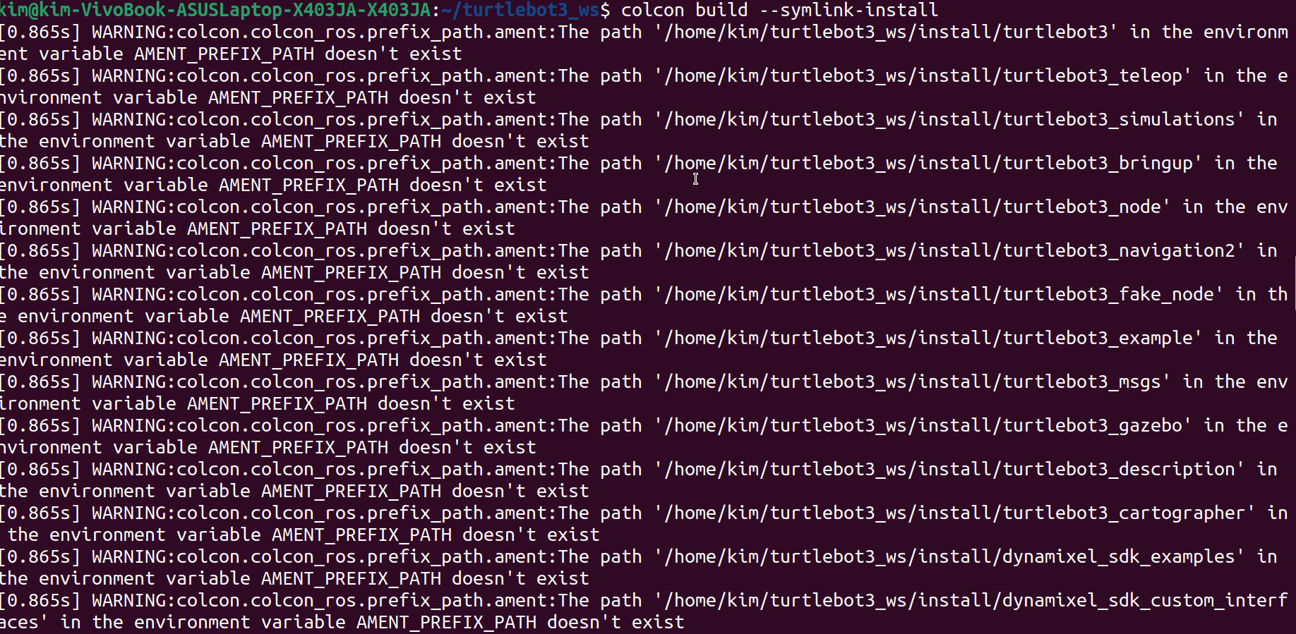

colcon build --symlink-install 입력했을 때

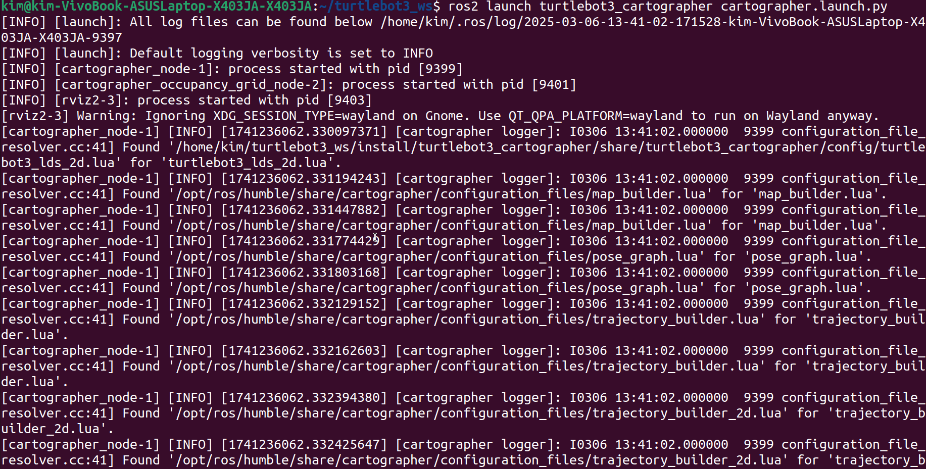

ros2 launch turtlebot3_cartographer cartographer.launch.py 입력했을 때
가상 머신은 안 쓰고 있고, 윈도우와 우분투 듀얼부팅으로 사용하고있습니다.
안녕하세요.
담당자 분에게 확인 해보니 turtlebot3 저장소의 humble 버전에서 나타나는 결과인것 같습니다.
혹시 올려주신 터미널 이미지들이 위의 안내(터틀봇3버거 slam 에러가 발생합니다 - #10 by YunWonho)를 따라 하신 결과인가요??
만약 안하셨더라면 다음을 따라 주세요.
1. TurtleBot3 패키지 삭제 및 다시 클론
먼저, 기존의 TurtleBot3 레포지토리를 삭제하고, 최신 버전(main 브랜치)을 다시 다운로드하세요.
cd ~/turtlebot3_ws/src
rm -rf turtlebot3
git clone -b main https://github.com/ROBOTIS-GIT/turtlebot3.git
2. 워크스페이스 정리 및 빌드
cd ~/turtlebot3_ws
main 버전의 브렌치로 clone 해주시고 문제가 다시 발생한다면 알려주세요.
감사합니다.
네, 위 내용은 말씀해주신 부분 다시 해보고서 실행한 결과입니다.
