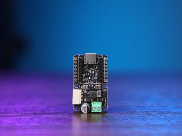

Does Robotis ever intend to make a Raspberry Pi hat for Dynamixels? I can’t believe that the Pi has been around for years and has super high levels of interest from the robotics community, but Robotis has never made a hat for it. I would love a device that could power the Pi and communicate with it, while having on-board capacity for handling messaging with (and high speed updating of) the servos. The closest they seem to have come is with the OpenCM9, which I have used with AX-12s and works great, except it won’t power the Pi and wiring communication between the Pi and the Dynamixel is inelegant. Also it seems like they have stopped making the OpenCM9 as it isn’t in their store anymore. On that note, does anyone know if something like this would work:
It looks like it has 3.2V logic for the data line, whereas I believe Dynamixels use 5V. Otherwise, has Robotis validated this:
@billmerryman, can you clarify about what you mean by the DXL HAT “powering the Pi”?
When I looked more closely at the documentation of the RPi Zero DXL HAT, is is using DXL Protocol 1, so AX series is OK, but not XL series which is on Protocol 2.

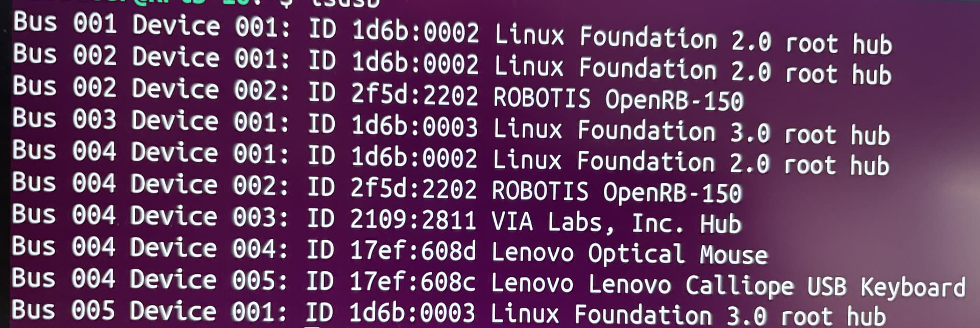

Or using “reverse thinking”, I just started on a project using RPi5 (on Ubuntu 24.04) talking to 2 RB-150s. I have not worked out all the details yet, but for now the RPi5 is reporting connection to the 2 RB-150s OK (as ttyACM0 and ttyACM1)
